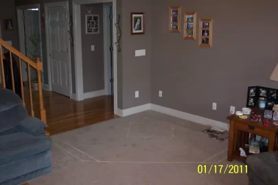

I am attaching a photo of the wall I will be installing it in.
Which stove would be best for me?

The F600 might be a bit tight to load from the side based on the picture, since it comes with a right-side loading door only. The F500 comes with a left-side loading door.

Based on the crowded furniture in this room and proximity of HD TV I say neither. My vote is to put in a convection or a soapstone stove.

This stove is a very powerful radiant heater, so do think about BeGreen's concerns over the proximity of furniture, TV, etc. If you run the F600 at Jotul's recommended stove top temperature range of 400 to 600, it may well be too much heat depending on the size of the room.
I would re- think the location. Way to tight to really get the BTUs out of either stove without throttling down and creating creosote. Just my opinion. Be safe.
Ed
I have to agree with the convection stove suggestion based on that photo. If you HAD to buy a Jotul, I'd go with the Oslo. You'll still get overnight burns. In my opinion the Oslo is an easier and friendlier stove to use..and the door opens on the correct side for your set up.

Can't see a 600 there unless you put it parallel to the wall rather than at a 45 to the corner.
Stairway and entrance makes it look like it will be tight going in and out of that room.
You won't be sitting on that end of that blue couch in the Winter. :)
Yes, the stove will be going parallel to the wall, not in the corner.

....the porcelain tile hearth will be 7-1/2' across the back and out from the wall, with 45'ed on the end. It may have less of a 45 than what the picture currently shows, depending on which stove I go with.

It does seem that a stove in that area could be pretty tight, especially since it looks like a heavily traveled area in the house with the stairs there and also the entrance to the room. Is this the only area in your home where the stove would be practical? How about installing it farther down the wall instead of right in the corner at the stub wall? I would not want a stove there in my home, but there is not a lot to go on with the one photo.

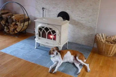

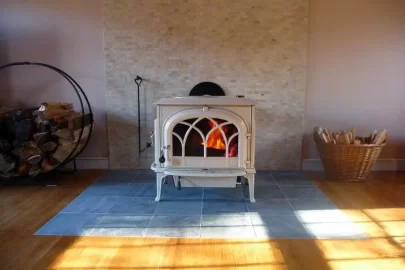

Well I'm not in TN, but this is a great excuse to post pics of my stove.
Nice, the install looks like it's straight out of the catalog CN. Pup looks pretty content too.
