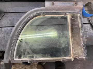

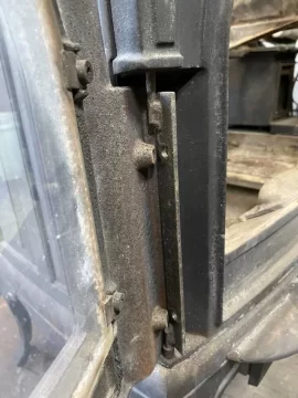

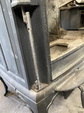

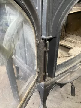

Here is a 600 I did awhile back and took pictures of the breakdown for someone else. Here is the door part-
[Hearth.com] Jotul F600 Door Removal [Hearth.com] Jotul F600 Door Removal[Hearth.com] Jotul F600 Door Removal[Hearth.com] Jotul F600 Door Removal
