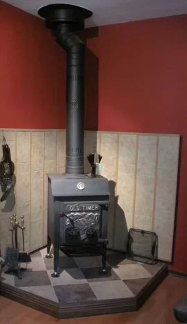

    Here is the current stove that is being replaced

    If you can have it come out the back, go for it, as it will give you a little more room to use the top to hold a kettle or pot. A 6 inch double wall pipe coming out the top leaves very little room to cook.
