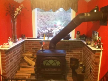

Good morning all. So the Oslo came in, a week late. I ordered it with the short leg kit as the vc 2040 was 25'' to the flu collar and the Oslo is 28 1/4 without the short leg kit and 26 with. I've tried every combination of the existing pipe I can think of, with no joy. So, couple of questions:
1.) I imagine the short leg kit will remedy the prob?
2.) is there a "flexible" angle pipe that can be used?
3.) is it safe to attach a 45 directly to the flu collar without using a stovepipe adaptor first?
I have attached a pic to aid in any ideas. Thanks for reading!

Since you'll have the short leg kit coming just in case, why not modify the stock legs to the exact height you need?

As in cutting with a torch or something similar? I suppose I could try that, but I don't think I want to start cutting pieces. Ill wait for the legs if I can't figure out some sort of pipe configuration that'll work.

I'm pretty sure the legs are cast as well, so a torch would make a mess. But a cut off wheel or sawzall should work fine. Measure twice, cut once. You could also just get a replacement longer straight section of pipe and cut that to fit.

I'd rather see if there is a pipe configuration I could do. I have a 4 foot telescoping between the 45s. On the encore it went 45 off the collar, 18'' to the 4' telescoping, a 45 to the thimble. No stove pipe adapter. I'd like to get the adapter on there this time.
Could you use all 90's like mine? I do have a 35' chimney to help draft.

I think I probably could. I was told not to use a 90 by the dealer, but I have a 30 foot draft so I bet it would be ok. Thanks, il look into that!

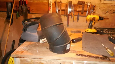

You can buy adjustable elbows that can be configured to any angle.

My setup has incredible draft even with three 90's. One tee on the outside.
It is easy to over fire the stove. Maybe with a shorter chimney there might be issues with the 90's.
Dealer has an adjustable elbow, should work without having to get the short legs and be able to leave on the stovetop adapter. Off to the woodstove store! Thanks for the help! Can't wait to start burning again, been a cold couple of weeks since the anchor was removed. On a side note, the Jotul manual says nothing about MC. It only says that wood seasoned between 6-14 mnths is best!

Get 2 adjustable elbows and you'll have no problem.

I'm gonna get two elbows like you suggested. I think I can get away with one, but I'd rather have and not need. Thanks!

I'm not sure one could pull that off without a 35ft chimney. Three 90 deg turns are usually a draft killer.
Is there a telescoping length of pipe in the connector?. Looks like one or two sections of telescoping pipe would make this easier.

The adjustable pipe they has wasn't double wall. It still fit, but the airspace holes are exsposed on the telescoping piece that the new adjustable goes into. Wondering if this will be an issue? Thanks to everyone for the help.
