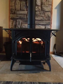

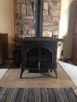

I just installed an IR this spring. Burned very little with it but love it so far!! I use the top load to scrape ashes back from the front before I open the doors to keep ashes from falling out. Also have the side shelves and love the looks of it.
