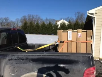

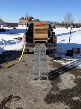

Quick overview of how I installed it:
-I used a pulley on the truck so I can lower the stove down a ramp onto the ground while two of my friends helped guide it down. (This was actually very easy and I thought this was going to be the hard part)

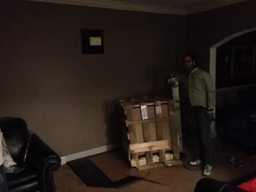

-We then used a dolly to roll it over to the garage door which was very easy
-Then we used an appliance hand truck and used the same ramp to get the stove up through the garage door (2 steps high). Two of us pulling and one guy pushing. It was extremely heavy even with two of us holding the hand truck (This is because the stove is packaged so that it is sitting high on top of the pallet for easy installation of the legs and this caused most of the weight being up near the handles). We needed to take multiple breaks.
-The hard part was maneuvering this thing around the inside of the house trying to make turns and not destroy my floor (I did put some dents in my hardwood floor and the wife is angry _g, but I looked up a way to get them out and I should be able to do it with a wet rag and an iron...I hope!) I did put down wood to roll on, but the hand truck came off and made a long dent.

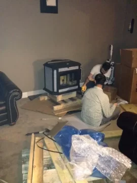

-Once we got it into the stove room it wasn't too bad and we assembled it on the hearth pad fairly easily.
If I ever want to move this stove again I am definitely going to hire some guys to move it. My opinion for anyone who is planning on getting this stove and installing it themselves. I recommend using a dolly and put plywood on the floor. We moved it easily on the dolly, but couldn't get it up the ramp so we switched to the hand truck.

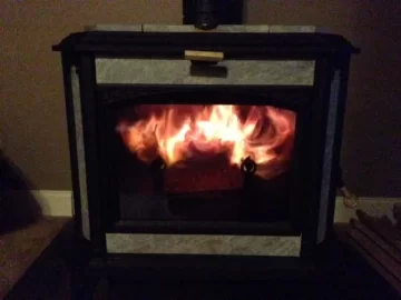

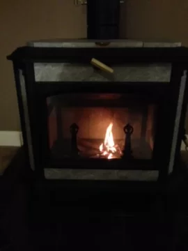

So we finally finished assembling it last night at around 10pm and I did a small kindling break in fire and that burned out after about 15-20 mins. Then I waited about 15 mins and lit another kindling fire with 2 very small splits and let that burn out. This morning I lit a my third and final break in fire and it had kindling and 2 medium splits and the stove got up to 350 degrees and stayed there for a little while before coming down slowly in temp. So now when I get home from work she should be ready for a nice hot fire! I can say the heat I feel radiating off this stove at 300 degrees feels equivalent to my Mansfield at 400. I can only imagine what this stove will feel like at 550-600. I can't wait! ==c

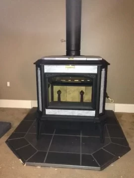

Okay so here are the final pics of the install.
This stove is a BEAST! I brought it up to 515::F last night very easily on just a few splits and it really puts out some heat. I love how the intake is so sensitive and easily adjustable. I have a lot of playing around to do this weekend...even though its supposed to be almost 50 degrees out :mad:

Here is a question for other PH owners. How can you tell if the cat is lighting off? My top center stone never went above 350 but the cast iron near the top flue exit (I have a top exit flue) was 515. I checked the cat this morning and it seems to just be resting freely in the slot, but it doesn't rest flush with the gasket behind it so I think the exhaust may be going around it a little bit. Then they stuck an extra piece of gasket in the gap between the top of the cat and the slot so the cat couldn't rattle. Does anybody else have this?

You might want to check your clearances, especially the door side. Is that carpet around the pad?
I have the "newer" PH. Your cat sounds good. Did you push it tight against the back gasket? I think it "sticks out" about 3/4 to an 1" or so.
Yes I have hearthpad extension there now its just not in the pic. Yes that is carpet around the hearthpad, but there is no carpet underneath the hearthpad. Will that be an issue?

I did push it tight against the back gasket, but it just feels like its not flush on the backside of it. So your saying that my cat did light off with the top center stone at 350?
From your last pic. it looks like your clearance from the door to the carpet is a little close. If you have an extension then you might be good. Just check them. I had my first few fires in the PH with the front legs resting on the wood floor.....
