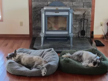

My house is new construction, and when I told the builder that the stove was over 700 pounds and the hearth 300 pounds, he beefed up the flooring support under the hearth area. He said it probably wasn't necessary, but did it just to be on the safe side.
Do you know how he beefed it up? Did he screw extra 2x4 supports along the side of the floor joists to help straddle the load?
I love your setup, I saw it in one of your other threads and the stove looks great there. Where abouts are you on the Jersey Shore? I used to live in Monmouth County which is near Belmar and Seaside.
I'm guessing yes. It's pretty common to sister additional 2x4 or 2x6's to help carry the load. If it's new construction it may even be 2x10's. That's what my joists are in the basement.
[Hearth.com] Just brought home my new Progress Hybrid
Thanks. My house sits on the side of a mountain on bedrock with a 5 foot crawl space. The builder doubled up on a few floor joists in the hearth area and put in an extra support column from the joists to the bedrock. Perhaps it is overkill, but I sleep better at night. :)
My NJ home is in Lavallette, just north of Seaside. I spend summers there and the rest of the time in Tennessee. Best of both worlds for me.
