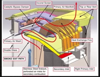

Tony, I keep my stovetop thermometer on the cast iron deck behind the soapstone, just before the flue collar area. I believe a lot of owners do. It gives a better. quicker read for engaging the cat. I leave the thermometer there. On a hot fire it goes up to 525 or so. I usually run the stove at 425 or 450, temp read there. I believe it gives an accurate understanding of the firebox temp...about twice that on the thermometer. just gets there faster than on the soapstone. I also believe that is where Wolf has he thermometer when he is reading the stated temperature. It's not the exit temp to the flue that he is reading.
