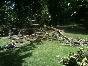

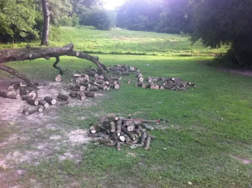

I said the heat would silence the stihl but the old lady wanted this oak took down because it shaded where she wants to plant some fruits trees . This will be an early morning and late evening job until done. This will go in the 17-18 winter pile

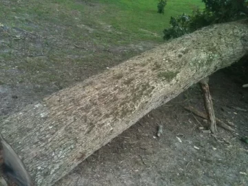

It was fairly healthy but deformed. Has an oak twice it size close to it and robbed all its sunlight

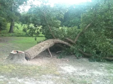

Now I understand what he meant. It fell like it was suppose to. I just didn't quite hit my lines on my back cut. Was cutting with my 16" stihl ==c

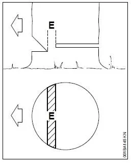

Yeah, I don't know if it's the angle that the pic was taken at or what, but it looks like the saw came in below the "vee" of the wedge cut, instead of above. :oops: On a bigger trunk, I'll start the bar on what I think is a good plane, and when the bar is in 4" or so I'll turn the saw off and leave it in the cut. Then I can walk around and eyeball the plane of the bar from different angles to see if it looks like it's going to end up in the right place above the floor of the wedge cut, to leave a good hinge intact. Sometimes I'll make the wedge cut, then wrap a piece of twine around the trunk at the level I want the back cut, and mark it with a piece of chalk. Lately I've experimented with scoring a line with the saw chain from where I want to stop at the hinge, and pull that score line around to the back where I'm gonna start the back cut. I do that on both sides of the hinge mouth, then pull those score lines back where they're easy to see when I start the back cut. Then begin the back cut, stop like before and turn the saw off, and see if the back cut looks right. Pic from a Stihl manual...don't want to end up in jail! ;lol
