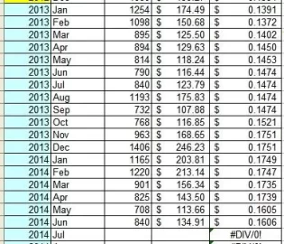

Actually closer to a real price of $0.16 - $0.17/kW presently if you total both generation, delivery, etc. The $0.12 is likely just the generation, which I believe is the number National Grid cites to make it sound good. It's gone down a small amount in the last few months. Chart below is total kW divided by the actual bill amount to reflect the "real" price per kW. I keep a running record.
