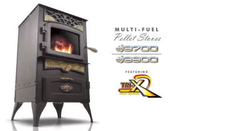

Congratulations. This is a nice looking stove. And a very lucky find for only $300,-

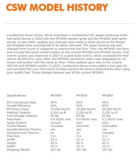

It's hard to tell the exact model from your pic. According to the Cumberland web site these models exist:

if it is a 3800 it is a great stove, cant say too much about the others as i have no experience with them. that stove will burn the crappiest stuff you can throw at it as long as you keep it clean.
if it has a remote with a cable on it, its a 3800. If the controller is permanently mounted on the side it could be one of the earlier models. I have a 3650 and its my workhorse. One thing to be cautious about is the manual feed or "add pellets" button. Push it once and it stays on continuously feeding pellets at a high rat. You must push I again to make I stop. Never push it and walk away or you're in for a big surprise.
