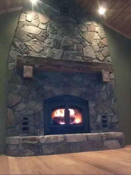

Thanks LP! Its random width and the old square forged nail holes really look great. I still have to sand and stain it yet. But we love it! It was a TON of work but well worth it.Floor looks like it turned out well Scotty.

I did the whole install, SO. All the stone is off of the mountain by our house. It was a big job but worth it in the end. Go to the link in my signature to see the install pics.Im jealousHow much of it did you do yourself? Really looks like professional work.
Thanks! It was a ton of work but I'm seeing the light at the end of the tunnel, and I'm getting excited!Wow Scotty, that is a wall of beauty! The floor and ceiling look nice too.![]()

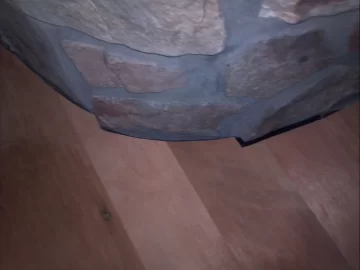

Blue, thanks for the compliment! I SHOULD have done that, but I didn't. Minor oversite, really. I just more or less 'matched' it to the contour of the stone, but left a 3/8" gap between the floor and the stone (to allow for expansion of the wood floor). I'll be putting in some graphite-colored sanded grout caulking (like you would use for around your tub in a tile installation) to fill that gap in......Here's a pic of the gap at that junction:Lookin' great as always Scotty. Curious how you treated the flooring where it meets the hearth. Did you leave a gap between the subfloor and the bottom of the stone to allow the planks to slide underneath or do they butt up against the hearth?
![[Hearth.com] Killin' the chill with the NZ3000...... [Hearth.com] Killin' the chill with the NZ3000......](https://www.hearth.com/talk/data/attachments/101/101571-d3349a35e81cfa514698201fc3611647.jpg?hash=09QMumxIJo)
