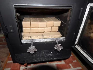

Never heard of Liberty bricks but I have burned several tons of Redstones, they are fairly inexpensive here possibly because I am only an hour or so away from the source. Had to be real careful with them in the Jotul not to have an inferno on my hands but the new Woodstock has excellent air control and low burn capabilities, the ecobricks really rock now!
[Hearth.com] Kiln dried as real as Seasoned wood. < before I finished stacking the front row so you could see the back rows...

View attachment 191263 < before I finished stacking the front row so you could see the back rows...
How many do you burn at a time
Depends on what I want to do. With the Jotul 550, I think around 12 was max and even that was hard to control.
With my Woodstock I've gone up to 24 bricks - that's about 84 lbs of really dry fuel - potentially over a quarter-million BTU per their estimates-be careful!! I have a thread documenting that long burn https://www.hearth.com/talk/threads/woodstock-ideal-steel-ecobrick-long-burn.152955/ I've only done that just a couple times to test though, got a great long and really low burn. Usually I mix, I burn some loads half ash cordwood with maybe a dozen or so bricks to get a nice day long burn. It's nice when I'm on just a few hours of sleep and getting up at 4am for a long day at work to not have to get up 20-30 minutes earlier to load the stove and have it last till I get home from the previous days load. I know most people have someone at home to keep the stove running when they are away but I'm solo here and on days I work I'm gone 14 hrs door to door usually, squeezing a few more btu in the stove is a plus. Sometimes I just use them as fillers since they are smaller than cordwood, I can usually slide all my wood to one side which leaves a small gap at the other side I can normally fill with a few bricks.
Keep in mind the Woodstock can burn in a fully catalytic slow burn, non-cats can't usually sustain a clean burn that low and you got to be more careful with these things on a higher burn.
