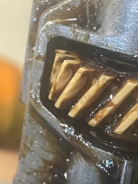

There was only one wearable, non metal gear in there. It only shows a little wear. I guess I really over loaded it, lol.
The guy said to watch out for the sharp drive gear. He was right!

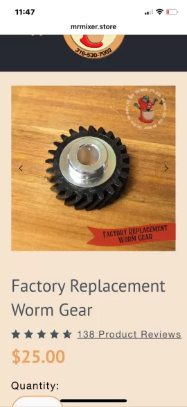

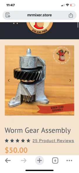

I’m going to regrease with white lithium and put it back together for now. Parts aren’t expensive. I think I’ll pick up an assembly for $50 and a new, spare gear for $25. I’ll drop the new assembly in and then fix the old one. If the gears are that sensitive, I may be swapping them often now that I’m kneading dough. It’d probably take me an hour to swap them out now that I know what’s involved.
Google shows the gears much cheaper, but the guy did go through the trouble to show me how to fix this. No idea if the gears are the same quality either.

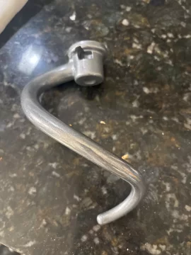

As long as you don’t burn up the motor and switch they last a long time. You might try the new spiral dough hook?
