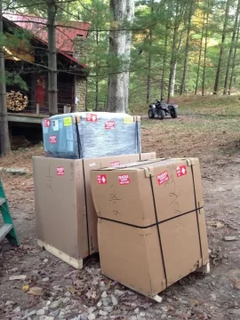

It's big. It's gonna have to sit there until Sunday when I can get a few helping muscular hands.
Been looking at my space as I prep for installation. It's going to be a little tight in this old house and will requite a custom plenum for sure.
[Hearth.com] Kuuma VF100 arrived
You buy the Cadillac of wood furnaces and the 1st thing you do is leave it outside for 4 days under a pine tree? I may have to come and replace it with a hot blast! That's just wrong. Would you buy a new computer and leave it outside? NO KUMMA FOR YOU 1 YEAR! Great purchase. Poor handling. :mad:
Haha. I have no choice. So far no rain !!!
It is wrapped up very tightly.
oh, and that Oak is protecting it from the pine :)

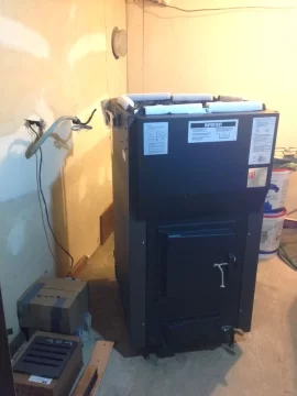

Got the furnace indoors. Been looking over the parts and instructions, seems fairly well-organized, but would benefit from more of a step-by-step approach with more and better illustrations.

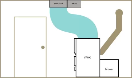

I'm tight on space and the house ductwork is nowhere as large as the output on the furnace. So I'm going to need a custom plenum that reduces the 24x24" square down to something more like 16x16". Hoping to keep the most cubic inches in there as possible.

Loading like that may be a head bumper. What about putting the furnace 90* Flue going strait to chimney with only 2 45'S and the ductwork coming off the unit going to the left? This will make it easier for the return as well.
Reactions: Monaco

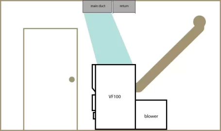

Yeah - after getting the furnace into place, wWe decided to slide it closer to the doorway like you suggest, allowing us a simple trapeziodal plenum like this:
