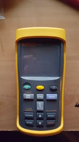

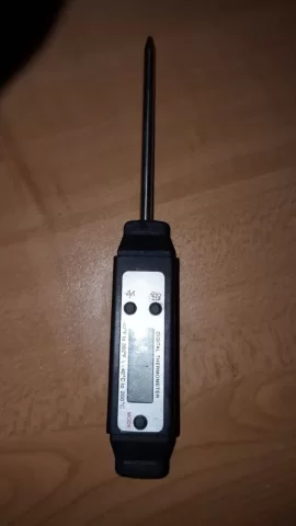

Dan - what kind of thermometer do you have to detect your supply temp?
I have -THESE- stuck in my plenum/ductwork in various locations.
BTW, my 63lb load last night made it 14.5 hours!!! lol I loaded it last night after the Packer game at 10:30pm, I got up this morning and saw the computer was on '2' and right away knew I wasn't going to be loading it before work so I asked the other half to load it when she came home from work for lunch, hoping there would be enough coals left. She called me at 1:30pm and told me she put 30lbs in and there was plenty of coals left to continue the fire. It got down to 17° last night and is currently low to mid 20's.
A digital probe, a cooper digital thermometer, A fluke, a testo. and many others, But generally use the cooper and keep it near by.
A couple of pics to see if they will go through after webfish's magic. Close up pic works, way to go webfish.
  • [Hearth.com] Kuuma VF100 arrived
