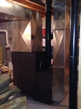

My ceilings are not near as high as yours. My issue was, to get the ductwork the way I wanted it I had to go from square to round back to rectangle. So it was not possible to place it at their suggested location. The high limit is about 18" now. I also happen to have a string from a pull string light that hangs in front of my basement vent, that lets me know what the fan is doing. I think I went the whole year before I noticed the high fan on, at start up. Not reload.

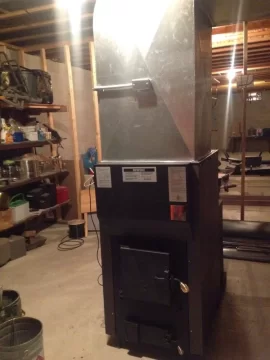

Monaco, it does sound like a bad fan sensor. But looking back at your pics the high limit that sticks in the plenum about 10-12 inches, is mounted at an angle putting the tip of the probe very close to the HE. This may be putting the fan in high all the time. (even then it should run a lot longer than 1 sec) I would move that a ft higher. Also do you have supply registers in your basement? or an always open basement door? Thinking of neg press in basement. Also what is slightly green wood? what kind is it, and how long was it stacked for? When the fan is short cycling how hot is the bonnet?(sarcasm now) WE TOLD YOU NOT TO LEAVE THAT OUT IN THE RAIN!!! :eek:
Have you checked for a good connection at the low limit? Those female adapters sometimes need a pinch to tighten them. Could be just poor connection.
High limit sensor:
What I did was measure the height from the tip to the top of the burner and mounted it high enough to keep the same measurement.

High limit sensor:
