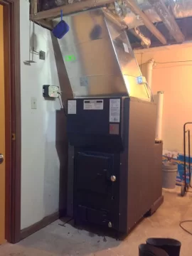

I'm guessing the blower was on high (the thermo calling for heat) and then the air jacket temp dropped below what the low limit was set at, therefore turning off the blower circuit. Having some HVAC thermometers would help you verify this by monitoring your plenum temps and comparing the actual temp to what the low limit is set at.
IMO, the stock location of the low limit button switch is not the greatest. It's on the side and is susceptible to cooler air, especially when doing a cold start. The air is blowing up from the bottom and the air which passes over it does not even include any heat coming off the heat exchanger or even all the radiant heat off the full main part of the furnace. If you mount it higher up in the plenum it will see hotter air from the whole furnace plus the heat exchanger. Hot air rises, it doesn't go sideways ;-) Daryl knows this but it's a UL listing thing, as he has to have it mounted and wired in order to get UL listed I guess.

I just got off the phone with Lamppa. They're really nice people and boy are they helpful.
They sent me a new computer and button temp sensor, and I have them installed. He advised I move the button sensor high up into the bonnet, which will make the sensing more accurate.
Over temp alarm:
When I installed the new sensor, I left it at 105. My fan shut off a good two hours before what it would with it set at 100-102F - giving me only about 8 hours of fan time. This morning there were a LOT of coals, so I loaded over top of them. About 3 hours later, the high temp came on. Daryl said the right idea is to always scrape the back of the firebox clean, down to the stone. Leaving coals there underneath a load of new wood messes up the front-to-back burn, causing excessive gassing.
So I'm going to move the button sensor off the side of the furnace up to the spot I have marked in green, turn it down a little, and will see what happens.
I think I prefer the 12 hour fan time. Even though air feels more lukewarm at the very end of the burm, it's still way warmer than outside, and it's still considerable, continuous BTUs going into the house - unlike when the fan is off.
That is exactly what Daryl just told me - he said it should absolutely go higher onto the bonnet - if you can. He said if they sold the bonnet with the furnace, it would be installed higher by default.
I would move the sensor to the back side of where you show. This way the sensor is actually over the top of the furnace due to the angle of your plenum and it will see a better representation of the temp coming off the furnace. As Daryl already probably mentioned, you will most likely need to raise your low limit as well, as you will notice the fan running almost all the time with it set at 100°. I have mine set at 115° with my sensor moved. May put it down to 110° when/if we get some real cold weather though.
Thanks - very good points - I'll move it to the back side. I'll enjoy being able to access the thing without a pocket mirror and double-jointed elves :D
