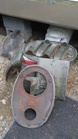

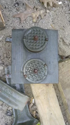

12pc teardown. 4 legs, bolts 5/16-18,3/4l,washers,no nuts. Torched off,tapped out ,new replacement bolts. 3 threaded rods replaced with 2 3ftrs 5/16,washers,nuts. With one orig threaded rod heated to bend hook,cut new rod to length. Wire wheeled old cement from seams 6pcs. light wire wheel touches to leg top/bottoms,bottom inner plate,door hinge/pins,latch. Oil up bolts on the vent wheels to get spinning.

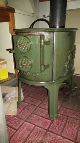

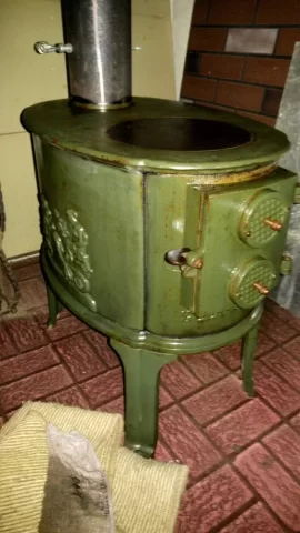

Getting ahead of pics/build for stove but it is cemented,together,washed down dried, vege oiled.
Test burn/cure.

Looks great. Before the stove is fired up you will need to move the adjacent table away. This stove is highly radiant and throws off a lot of side heat.
Yes it's in summer time work area right now/season, no fires . til area reworked for winter and summertime things winterized and moved away from stove area.
36x52 type 2 pad Had a waterford 100b pulled off the pad for the Lange to go in, removed severe rain storm and creosote spatter spot on it to clean up bottom pad. After total rebuild of Lange I didn't want it to get, a storm going through, wet so , call me anxious(more like no space available inside for two stoves. One out one in. The back has another faux brick and side wall little narrower pad solid type 2. Funny one pad cost me way back when 4times the cost of the yard sale Lange 6303 25 buck buy. Not to mention 2more pads,stove piping interior/ selkrit exterior and...
