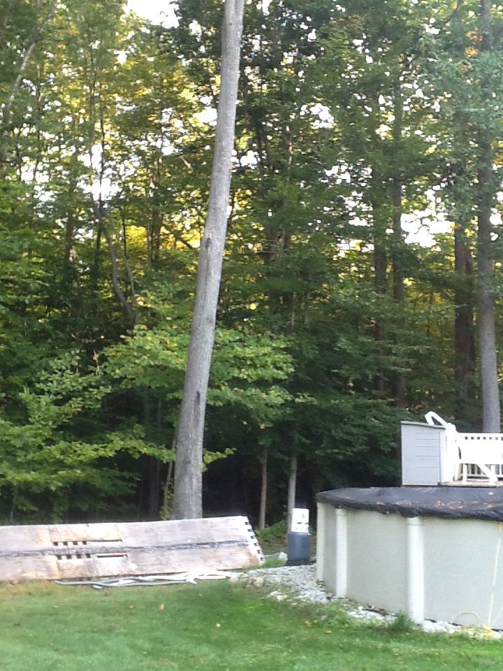

So I've got this very large oak tree (100-120 feet tall maybe), and it's branches are hanging over my pool. Acorns are ruining my cover and it's annoying getting all the acorns in the pool. It is leaning away from the pool and deck, but just barely. I'm also concerned about the tree getting hung up on the other tall trees in the area. Is this something I should even attemp myself? I don't want to hire someone...I'd rather deal with the acorns than pay a ton to have it removed.
That said, I see there's a lot of people in CT on this board. If anyone has experience in this sort of thing, and would be willing to lend a hand, I'd be happy to share all this oak wood with you. :)

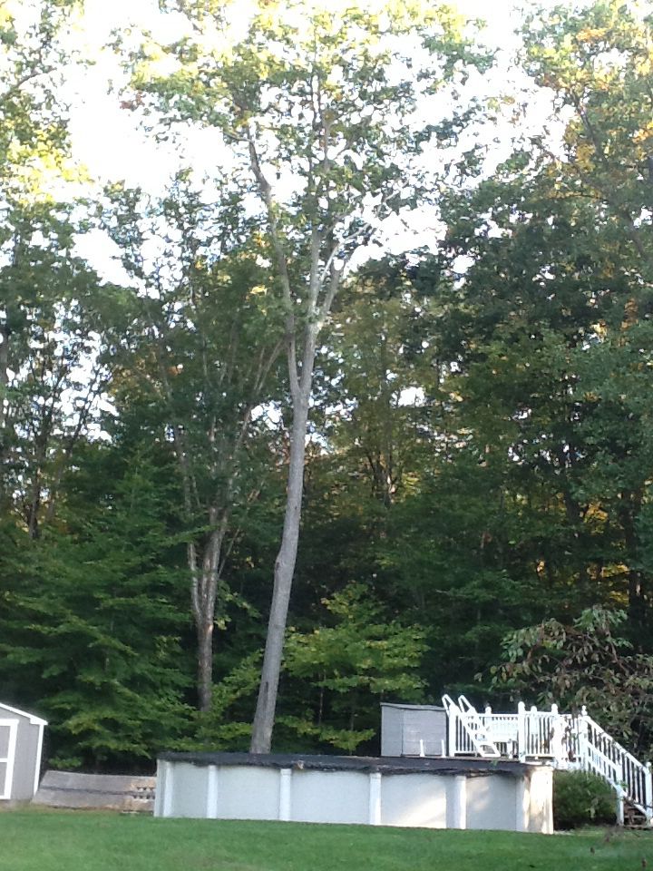

The tree right behind the pool...
[Hearth.com] Large Oak I need help felling - pics inside

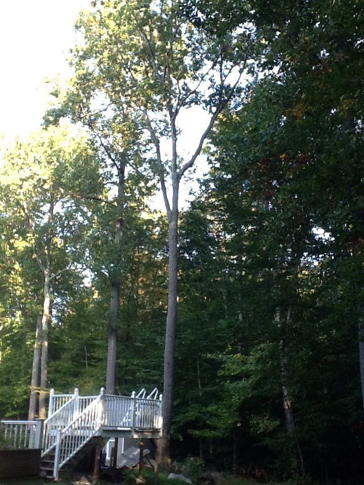

Ignore the plywood...that's the frame for my solar heater for the pool...easily removable.

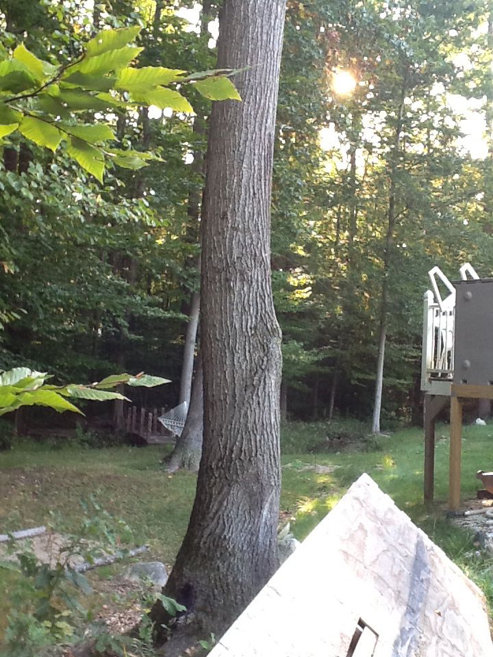

I think it would want to fall between the deck and the tree with the hammock on it...

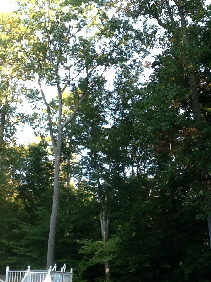

It's leaning right where the sun is at the moment...

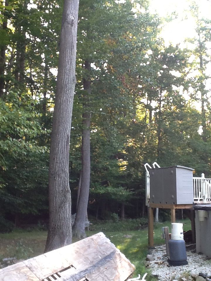

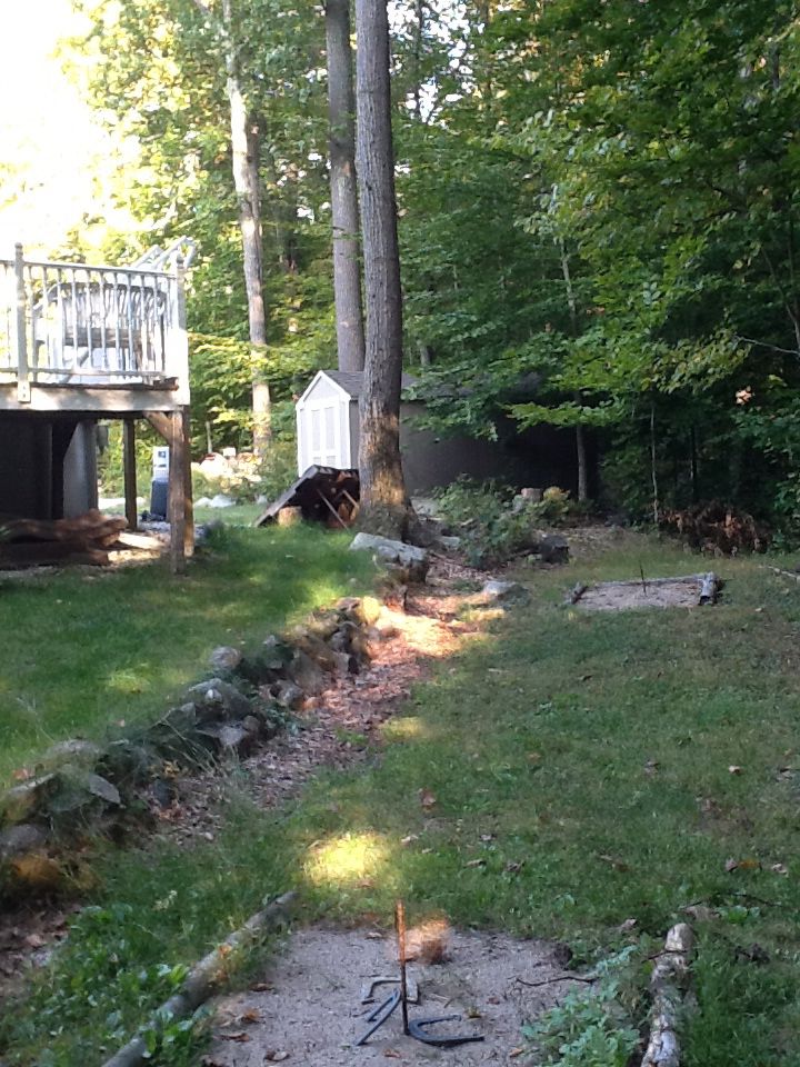

Another angle...

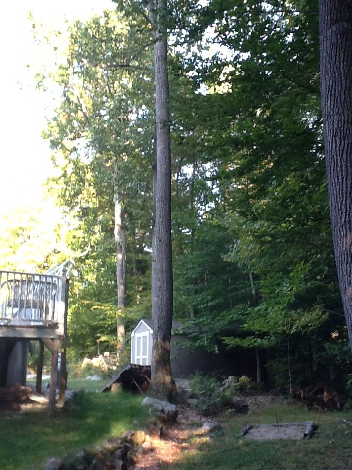

It wants to go right where I'm standing in these 2 pics...

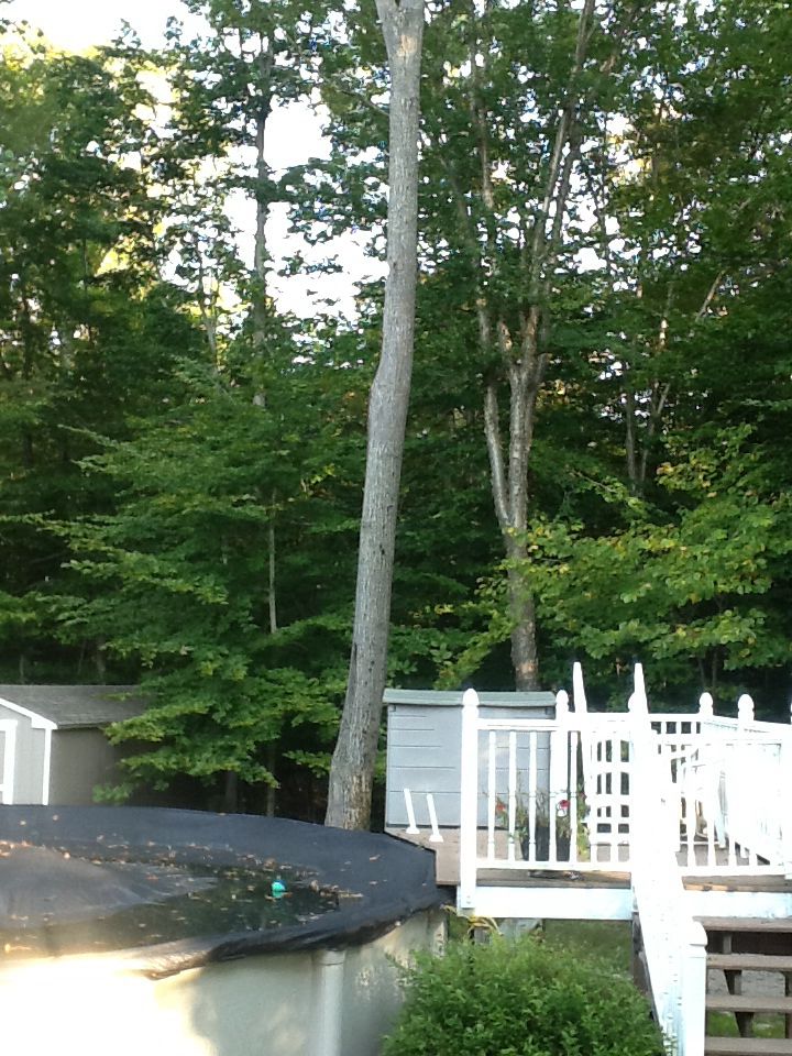

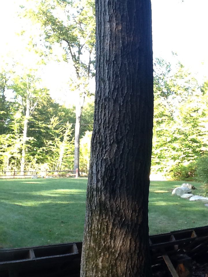

Too bad it wasn't leaning the other way...I have all this room to work with...
I would get a 4 wheel drive truck, attach a rope high up and pull it down on the grass in the large area. Obviously there are issues to deal with any job of this kind. Make sure it doesn't fall on the truck. (rope needs to be long enough).

I would rope the back weight out of the top or even rope the top out of you can get a climber local.. Ideal thing would be top it out using a speed line to remove the canopy.. Then the branches would all come down away from your pool.. Next I would use a false crotch to hold sections of trunk wood , as you cut them off and lower them to the ground.. Less damage to you lawn... Then with the trunk wood lower maybe you could pull it back into your woods, thus saving damage to your lawn. I guess I look at things different having done tree work in the past for a living.. I always hated leaving a big huge indentation in someones lawn... Do you have under ground water sprinklers? Main thing is to get the back weight off of the top if your pulling with the top on.. Word to the wise, where the tree is,, install 2 pull ropes...As you pull take up slack on the second rope,, this way the tree can't go back if the first rope fails for some reason.. A rope is a lot cheaper then a new pool.

You guys are scaring me. And rightfully so. I think taking this tree down myself is a risky task for someone with only a little experience in bringing down trees. I don't have enough know-how to bring the tree down in the grass area. The tree is clearly leaning in the opposite direction. I'm sure I'd take out my pool or shed. Realistically, I think I have 3 options:
1. Cut it the way it is leaning. It won't fall on my pool. I think it will land directly on my horseshoe pits. That's fine. I'm just worried about it getting hung up on other trees. That would s*ck. If the other trees weren't there, I'd choose this option in a heartbeat.
2. Call someone and have it taken down.
3. Keep buying new solar covers and keep removing acorns from my pool. (Leave the tree be).
You could pull it, you just want a nice open face cut and good hinge wood so it holds all the way over... another thing to think about,, if you pull it towards the lawn , if the butt tears off the hinge wood, theoretically once the tree hits the ground the limbs could twist the trunk and send the bottom where you cut the tree into the side of your pool.. In those cases we have cut the tree higher and installed a rope to keep the trunk and the stump together, a butt hitch , just so the trunk won't move off to either side and hit something.. better safe then sorry.. Just takes a minute to install the rope.. Or you could even tie the trunk above your cut and tie the other end to another tree to keep it away from your pool side,, once cut.. You just don't want the face cut to close before the tree hits the ground or it will tear the hinge wood loose.. now having a free butt to hit your pool side. Maybe call someone and just see what it would cost... Might be cheaper then you think...Make sure they have insurance.... It's funny when I did my tree work , people asked for a insurance certificate to be sent to them, no problem... My theory, insurance or not, once you do damage and fix the damage, those folks will never call you back or refer you to another friend.. So my thoughts were to do zero damage.. Need to rope something down in two pieces instead of one safely,, do it!

Call for estimates. Tell them you do NOT need a "removal." Just get the tree on the ground and grind the stump. You will buck all the wood and take care of the brush yourself. This should get you a much better price.

if we were there it would not take long to know which is the correct way to take it down. To me it looks super easy but for someone with not much experience, I can see where it could be a problem. As far as the other trees, it is always possible it might take a few small limbs with it as it comes down but is this so bad? What if it hangs up? That can be determined before the tree is even cut.
That tree is a good sized oak, but not huge. Just don't tackle it if you are not comfortable with it. Also, do not view videos off Youtube and try to follow them or you are liable to get into some trouble. Do not attempt to do something beyond your capabilities. As for felling the tree the opposite way it leans, you can if you prefer and it certainly can be done. With me, it is always a last resort and you'd best know what you are doing before starting.
With this in mind, why not see what it would cost to have someone drop it? That is all you want done is to get the tree dropped. That should not cost much at all and then you get the fun of bucking up that wonderful firewood. Or, get used to the acorns. The time for acorn drop is really a short time of each year and a long handled broom would clear that pool of the acorns really quick.

I think two ropes, one that can be wrapped around something as to be able to keep taking up slack and yet hold the tree as you go.. The other rope, attach to a come along, and that will pull the tree over.. Just have a wide angle on the face cut so it won't be closed as the tree comes over, leaving the hinge wood in tack... That tree doesn't even need to be climbed to set ropes.. I'd use a throw ball and get the throw ball over a main crotch in the middle of the crown.. then pull your rope up and over the crotch bringing the tail down.. Now tie a half hitch and a bowline just above your cut on the trunk. set a second rope a bit above that one , pulling it through the same crotch or one by it .. Now you have two ropes set, never climbing the tree... So if a tree crew comes they really need not even climb the tree, that's a very quick way to set lines... With a second rope holding , that allows you to release and adjust the come along if you need to , in case you needed to shorten something up to complete the pull.. You have a way out with a second rope.. Winter sounds like a good time to drop the tree.. ground will be frozen..

There is no guarantee the tree will come down in the direction you think its leaning. You should still use a rope in tight places.
if we were there it would not take long to know which is the correct way to take it down. To me it looks super easy but for someone with not much experience, I can see where it could be a problem. As far as the other trees, it is always possible it might take a few small limbs with it as it comes down but is this so bad? What if it hangs up? That can be determined before the tree is even cut..
I'll admit it's not a 3d image, but I've got to agree with BWS.... this doesn't look remotely hard to me from the pictures...
Yeah, the pictures seem to show a situation that I'd be comfortable falling with it roped. However, I have been fooled by pictures.
