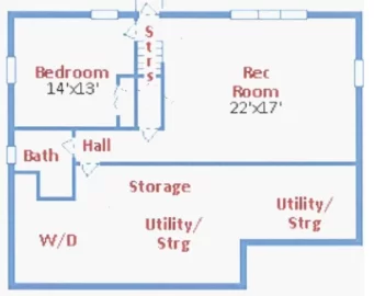

Attached a copy of the floor plan and a picture of the living room. Chimney is external on the side of the living room. It doesn't feel that small but it's really only a couple hundred square feet (20'x13'=208 sq ft). The living room opens into the DR with no door and a hallway which leads to the three bedrooms on the back of the house. What do you guys think?

You should be ok with the large unit. The large opening to the other parts of the house will help a lot. 2500 sq ft is the maximum area this insert will heat and even that is an estimate depending on many variables including climate zone, house insulation, ceiling height, wood species burned, etc.. The lower range is listed as 1500 sq ft.
