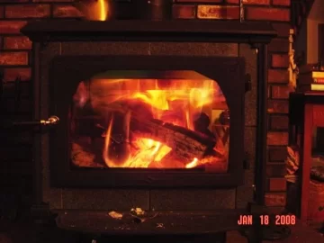

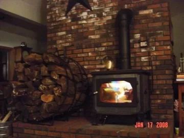

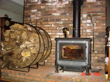

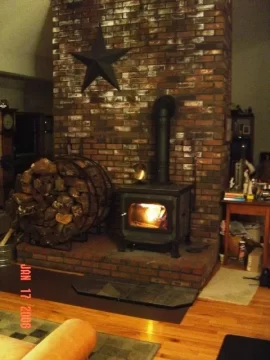

Pictures, pictures, pictures!
  • [Hearth.com] Last Night, I'd had it: Goodbye Defiant; Hello Mansfield!
Just looking at that makes me warmer.Cannot wait for my install to be done and start having that at home.Phil
Awesome stove man! I've been following most of your posts and responses regarding this stove. It's been invaluable in helping me lock into my Heritage's sweet spot!
Now I've just gotta get the Fiance' to reload when she gets home and we'll have some great 24 hour burning going!!!
Looks great!!
I bet that baby will be keeping the house nice and toasty

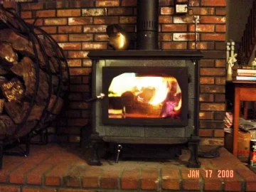

Looks good, even the ecofan is spinning so you must have had a good stove top temp.
I've got an odd HS specific question. How did you attach the first section of pipe/adapter/whatever to the stove's collar? I see you have an adapter piece in there with no damper but I can't see how it attaches to the HS non-predrilled collar.
Nice place.
Nice place.
That's strange, HB... unless I misread.... are you talking about the reversable collar on your Heritage? Mine does have 3 pre-drilled holed in the cast collar.

Nice looking install, but aren't those racks awful close to the stove? - I thought NFPA said you were supposed to have 48" to non-wall combustibles? (I'll admit I think that's a bit much for firewood that gets rotated through fairly fast, but... I'll even admit that I keep mine closer than that, but not as close as yours is...)
Gooserider
Jefflee1, hey I dont want to hi-jack the thread so I sent you a PM.
Gooserider said:
Nice looking install, but aren't those racks awful close to the stove? - I thought NFPA said you were supposed to have 48" to non-wall combustibles? (I'll admit I think that's a bit much for firewood that gets rotated through fairly fast, but... I'll even admit that I keep mine closer than that, but not as close as yours is...) Yeah but its a soapstone stove aren't that skin searing heat of a cast or steel. Plus he's just warming it up so it burns better in that big ole stove
Gooserider
The Mansfield has an 18" side clearance to combustibles. It's hard to tell from the pictures, but it does look like only about 8-10 inches to the closest wood in the hoop.
Did you mean NFPA clearance to combustibles for unrated stoves is 36 inches?
I think I am in error Harley, the collar did have holes now that you mention it but they were not spaced to line up with the premade holes in the double wall. HS told me that I would have to drill new ones. The installer and the inspector said it wan't required or needed so my double wall slip piece is only twist locked at the ceiling and then screwed together at the slip joint, setting on the collar.
The wife has the heritage at 550 right now which is higher than I like. Setting a record.
