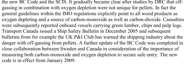

I do not have a bulk storage (in a confined space with practically no chance of air transfer the usual cause of death for these cases is severe lack of oxygen) silo or space nor am I connected to any auger system dumping pellets into a burner system.
Such systems start out oxygen depleted. So even a very small amount of anything else usually is in high concentration.
Since they haven't provided any actual test results in any of the information I've seen it is quite possible that this was a contributing and even possibly the real issue.
The US CDC has information on some 600+ cases of death in what are classified as confined spaces.
In 42% of the cases it is oxygen deprivation that is the problem, cases of this nature can involve just opening the access area, going inside, and expiring.

From your PDF Sophie:
