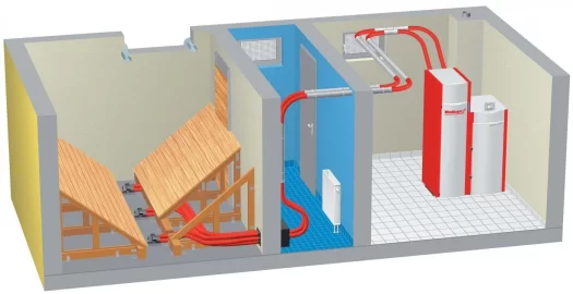

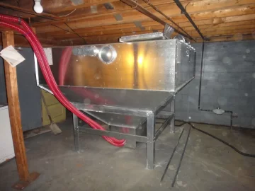

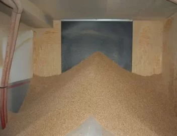

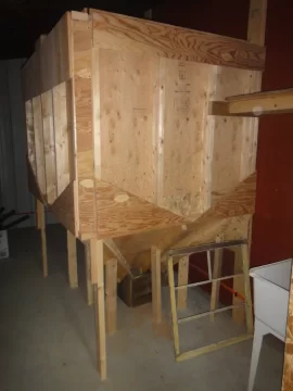

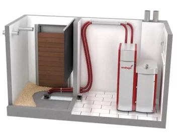

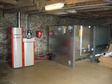

Some examples below
  • [Hearth.com] Lethal carbon monoxide poisoning in wood pellet storerooms
