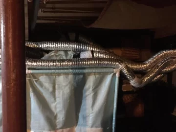

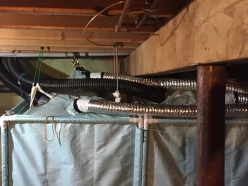

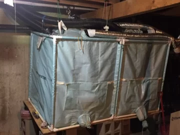

 ....in the for what it's worth dept. Here are pics of my 2 bulk fill pellets bags. Combined total of the 2 is a smigon under 3 tons. It's hard to see, but on the top of each bag are two circular vent flaps atttached to 2 dryer hose. As each bag is bulk fed from the truck, the two hoses go out my basement window, completing the venting process. The bags do "breathe" but you still have to have an escape venting route for the exhaust/dust! The bags are empty now. Vermont Renewable Fuels comes this coming Monday morning to drop off just shy of 3 tons of Green Mountain Pellets ( Softwood)Not true. There is CO produced when pellets off-gas.Carbon DIOXIDE is what is put off from composting wood and what is in farm silos. carbon monoxide is a gas that comes from incomplete combustion Of various fuels. Both deadly killers. If you have carbon monoxide in your pellet storage area it's not your pellets.
