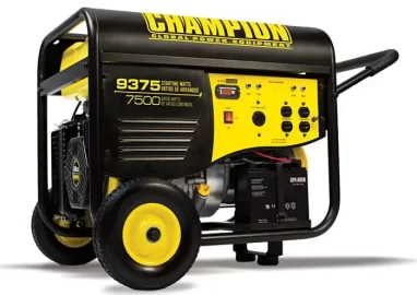

    I have a potentially dumb generator question.....
    I have a Champion generator, which I bought at Costco last year after Irene. I bought it largely to run my sump pump, which gets a fair amount of action with these heavy rains. I don't think I can insert a link, but it is the Champion 41537.
    Anyway, I am not certain that I understand the 120/240 plug. The generator came with an extension cable which plugs into the 120/240 "NEMA L14-30R" on the front of the genny - it's a twist connection. I think I uploaded a pic of the extension cable below. The other end of the extension cable has four outlets and is designed to allow both regular plugs as well as NEMA 6-20 plugs. On the genny, the outlet is labeled as 120/240 volts. For that outlet, the manual states as follows:​
    120/240 Volt AC, 30 Amp Twist-Lock Receptacle - (NEMA L14-30R) – May be used to supply electrical power for the operation of 120 and/or 240 Volt AC, 30 Amp, single phase 60 Hz electrical loads.
    I don't see where there is an option for me to set the outlet to either 120 or 240. I would like to use the extension cable that came with the genny - to get the cable into the house and then use the four available outlets. Setting aside the issues with "dirty" power, will I have any issues if I use that outlet from the genny and that extension cable? I'm concerned about the reference to 240 volts and the various types of plugs. Is it possible that it will provide too much power? I would like to be plug in my fridge and my freezer to that extension cable.

    A 120/240 outlet has four wires. Two 120 feed wires, a neutral, and a ground.
    The way it works is that when one of the feed wires is giving +120v the other is giving -120v. If you were to measure across both wires at the same time, you would get a reading of 240v
    Your extension cable has four outlets. Two outlets will attach to one of the feed wires, the other outlets will attach to the other feed wire. No chance of getting 240 using the outlets. To get 240, you need to use both of the feed wires on one appliance at the same time. In order to do that, you need a different cable. Probably a big challenge to find that kind of cable around here for about two to three weeks.
    Biggest thing you would need to be concerned about is leveling the load. You don't want all of your appliances on the same circuit. Try to spread the load across both circuits.
