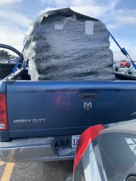

Which is preferred? Rural king has both. I told them I need a pallet loaded on my truck and he brought Lignetics.
I walked back where they keep them and saw the Freedoms. They were obviously newer and stacked fresh.
I have never burned either. I thought about telling him to switch them because the pallet of Lignetics was leaning so bad I wasn’t sure I’d make it home. It’s obviously a very old ton. It’s easily visible that it’s weathered and the pallet is rotten. I felt around it and couldn’t feel any wet pellets. I’ve gotten pretty good at this method of finding wet bags. I went ahead and accepted it mostly because I’ve never heard of Freedoms and Lignetics were all the rage at one time. Hope they burn well. I hate returning pellets.

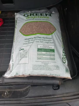

Tried a bag. Here is the data
Green Supreme - Allegheny Mountain Hardwood Pellets purchased through Leeway Ace Hardware
Purchased 1/6/23
Color Med brown, semi buff exterior
Pellet size between 5.84 - 7.25mm
Time to burn = 18hr, 07min
Average Glass Temperature (measured at center) = 463.54 °F
Ash weight (fully brushed out stove and burn pot) = 3.8oz
Ash description = granular to powder.
Glass cleanliness = 40% lite brown to black deposits.
Much more fine black ash on all interior sides of stove during cleaning.
Smell = Used Oil

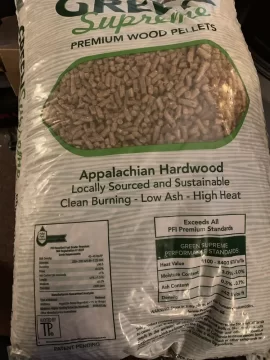

I checked when I got home. It was on same setting. This version of Ligs is Appalachian, it’s a different variety. They seem to throw good heat. The only drawback is there is a ton of dust. I almost feel like I need a dust mask when I open a bag. I wonder if the different titles like Allegheny and Appalachian designate the plant the pellets come from.

My bag was definitely Alleghany, Lignets is a good size company, over 500-1000 employees
That's exactly what they mean. That's why it's always important to reference what type of GS you are talking about because they are all different. There's a lot of confusion/misinformation on here in regards to GS because most don't state the type they are reviewing.
