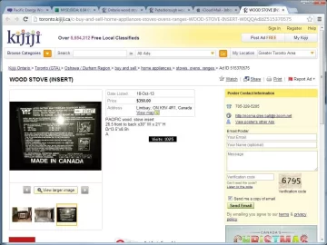

I am looking at installing a used Pacific Energy Super 27 -D in the Heatilator.

Thanks. I picked up the stove for this project.
Pacific Energy. Model : PACIFIC INSERT -D. mfg 1993. Anyone have any idea of the heat output of this model? I'm hoping it will heat most of my 2000 ft/2 ranch.
The stove is getting a good clean and upgrade. Need: Baffle Retaining Pin (any idea where I can get one?). A few new bricks, new insulation, paint and thermometric switch and rheostat.
