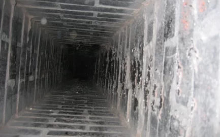

My 100 year old chimney was not lined at all .... just bricks (see pic)

It used to be that almost no chimneys were lined. Then, for reasons of safety and proper stove operation...as well as easier cleaning, the codes and practices changed over the years.

The biggest reason for insulation - in terms of the code - is the safety of nearby wood framing. When UL tests are done on liners with insulation, you can bet that they use a (faked) dangerous chimney to insert them in. In other words, they don't test them inside a tile lined chimney which just has some cracks! They would use the worst case scenario (to my knowledge), which is wood framing members directly against a single thickness of brick and the liner touching the brick on the inside. Then they fire up that liner to temperatures you can only dream about (or have nightmares about!)......like 2100 degree, hot enough to almost melt iron. Aluminum would have been liquid at 1300, brass would have melted at 1700, etc.
Since neither companies nor UL want to test for every scenario, they only test for worse case. But in the real world, many people line chimneys on a semi-voluntary basis. Or, they line a perfectly good fireplace chimney just to make it smaller inside, not because it is unsafe to hold a fire.
Again, I'm not privy to your chimney pics yet - but, in general, if your chimney was one brick thick and had no tile liner...and was near wood framing (and most are), then insulation would be required. If it were already in decent shape and the lining was for ease of cleaning and better draft, then it might be optional.

Yeah, by the letter of the code (which does apply everywhere...although the manual can supersede code, so the installers could claim it is correct)......most folks would insulate a liner placed in a chimney like that (with no flue liner).
Then again, that chimney looks to be more than one brick thick - maybe a brick and then a stone veneer, and the interior brick is in decent shape.

Code requires insulating the SS liner if there is no other liner in the chimney (which yours does not have), OR if there are visible cracks in the old existing clay liner (which you obviously don't even have a clay liner). So yes, to meet code you would need to have your new SS liner insulated. That much I do know. What I don't know is if an insurance company would pay a claim should you have a fire. You have contracted this crew to make improvements to your chimney, but the work was not done to code (no insulation in an otherwise unlined chimney). So while it is certainly more safe than it was previously, you also know that the work preformed doesn't meet the requirements... so it could be a little dicey should there be an unfortunate issue in the future.
I would just install a solid block-off plate at the bottom (if there isn't one already) and pour/fill the cavity with vermiculite. It's fairly inexpensive and it can be removed later should you need to remove it for any reason.
