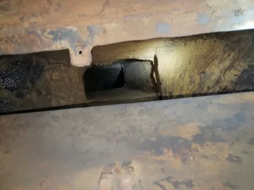

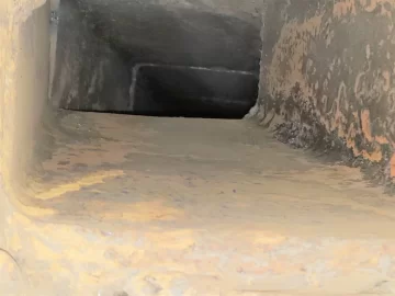

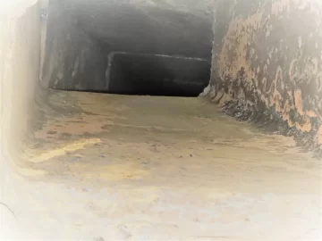

Offset of about 20 degrees then straight shot up 20 feet. Will post pics this weekend after I get home working in Philly during week. Stove is Hearthstone Castleton and will be set up to rear vent.
here are some pictures of chimney. The way it looks to achieve the correct draft I am going to have to go to a 4"x8" rectangle liner to get numbers stove requires. I want to insulate but believe it is going to get tight. ID clay flue is 63/8" x 103/8". Rockford tells me with insulation liner will be 5/12"x91/2". Just seems that if things aren't perfect I'm in for a long day. Here are the pics the offset isn't as bad as i thought and and it is very gradual to the point it heads straight up. Thoughts??
