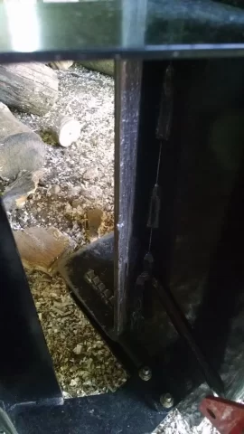

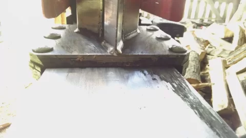

I have a 27 ton Ariens log splitter that has 6 - 7 cords on it. I was going to go out and split today and notice that on the back side of the beam where the wear feet are supposed to be wearing, the beam is jagged to the touch and has what look to be the beginning of metal chunks being taken out of the beam on both sides. Is this normal? I used the splitter in upright/vertical position, so no dirt is getting inbetween the foot and the beam. Seems like cheap metal to me. Am I missing something? I attached a picture that kind of shows what I'm talking about if I can figure out how.
It's kind of difficult to see, but if you run your fingers up the back side of the beam, you would get metal slivers in your hands. It's jagged metal being scraped off. On the one pic especially you can see it's actually dented and a chunk is beginning to come out of the metal.

Looks like the metal is galling to me. Doesn't necessarily mean it's cheap...I'd guess the stuff is generic A36 structural steel or equivalent. But the galling will happen anytime you have two similar (or identical) materials in rubbing contact with each other. ie the steel wedge 'sled' sliding on the steel I-beam. If the materials are dissimilar - ie a lead babbitt bearing / steel crankshaft, or a brass bushing/steel rod, then galling is minimized or eliminated.
So what to do??
1) I would check to make sure the splitter was not supposed to have some type of insert (brass, plastic, nylon, etc) to keep the surfaces of metal from rubbing. I don't know these splitters well enough to say one way or the other. But if they did have an insert, obviously you'd want to replace it, or install correctly.
2) If they don't have an insert, the best option would be to file/grind/sand the surfaces back as smooth as possible. You definitely want to remove any burrs, shavings, high spots, etc. Then you want to apply some type of grease to these sliding surfaces. Cheap / generic grease will do - you may want to wipe the slides down periodically and re-grease to help keep dirt/sand at a minimum. If you specifically like throwing money at the problem, you could go with a synthetic grease and/or something which claims to have 'extreme pressure' additives...probably double to triple the cost and may be very slightly better than the regular grease.
Agreed that you want to get that smoothed out. If you don't the wear will start to accelerate. Take a pic of the shuttle/shoe so that we can see how it is put together. It may be that you have enough wear that it is allowing the shuttle to "tip" and dig in. A nice end pic of the shuttle where it clamps to the beam would be best.
+1 It looks like the wedge is undergoing a "tipping" motion and digging into the bottom side.

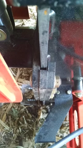

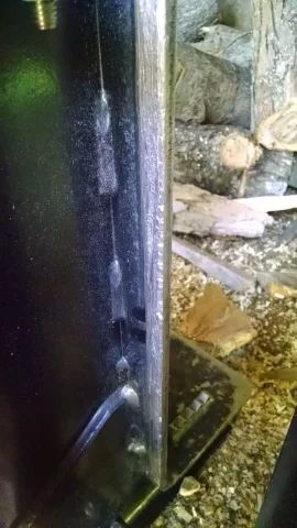

Here is one of the front and one of the sides. The other looks identical. I used it a bit more today and it just got worse. More carving out etc. So until I get that smoothed and and figured out. Looks like no more using the splitter. Thanks for the tips. Working with warranty right now too.

All those leading edges should be chamfered. If this unit is new enough I would sure be looking into a warranty claim. This thing appears to be cutting itself apart.

It looks to me like when the wedge was welded to the plate riding on top of the beam, the plate was upside down. The angled edges should slope up towards the wedge so the round rides up. Instead the angled edge looks to slope downwards, and would tend to pinch the round.
It slopes up. Pic just looks deceiving.
