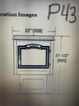

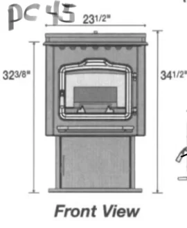

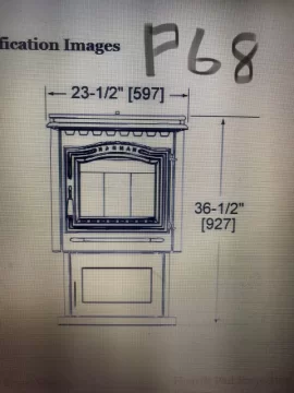

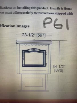

[Hearth.com] Looking for a high btu output stove [Hearth.com] Looking for a high btu output stove [Hearth.com] Looking for a high btu output stove [Hearth.com] Looking for a high btu output stove Just to fix some of the incorrect info, mine above included, here are the dimensions of the Harman stoves suggested. The PC45 is the same size as the P61, P68 is a couple inches taller than the P61 and the P43 is a tad bit smaller than both the P68 and P61. Hope this helps.
