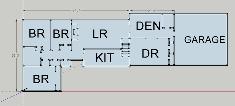

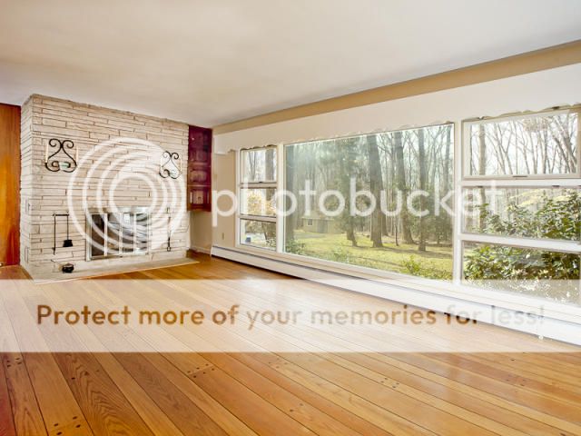

Here is a picture of the living room with the fireplace as well as a floor plan of the house. The garage is over a slab, den and dining room over a crawlspace and the rest over a 7' ceiling basement. Dimensions of the fireplace opening are 36" wide by 28" high and it is 24" deep in the middle (the sides and top taper down a bit toward the back).

Looking the plans, it may be a problem getting to the heat from the den to the bedrooms and you have a lot of glass.

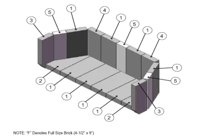

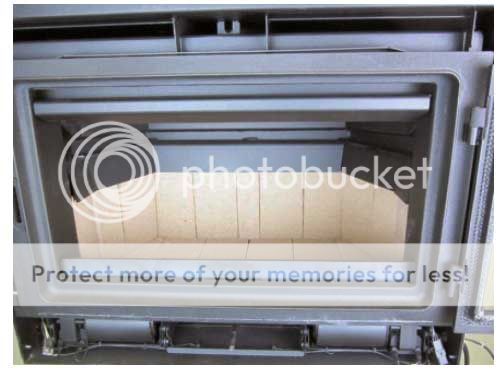

Looking at the FPX large hybrid manual I note what appears to be an exceptionally shallow firebox. It is only one firebrick or 9" deep. That would turn me off because it looks like in real practice one may not be able to load more than a few splits in at a time and only E/W loading, much like the Jotul Castine firebox.
Yeah I see what you mean there... if the firebox box is 24" wide but only 9" deep, it would have to be 24" tall to equal 3 cu ft.... that doesn't make any sense.
The manual for the Avalon Perfect Fit Plus which is the same thing shows two other views... looks like there is some space in front of the firebricks? Anyone have one of these and can confirm what the story is here?
