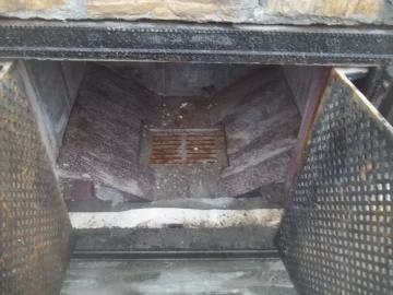

Those would be brick splits. Yes there is a difference between brands due to how they are made and the contents. Here is a discussion from the masonry heater association between people who know a lot about firebrick.
