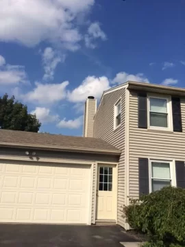

I uploaded the picture for my chimney. Any idea what a ballpark number for the cost of labor for installing a zero clearance if there is no outside working other than installing the liner and cap? I know two contractors off hand one charges about $25 the other charges about $35 an hour.
Lastly if the price gets to high, should I just seal off the side with bricks and put an insert in? I don't know how good it would look.
Also thank you for the link of people who can do fire places, most of them look like brick/mortar stores though.

Don't forget that if you convert back to wood burning, factor in the cost of the wood and the added time it will take for wood to dry properly. Most wood you buy is 'seasoned' and that can mean anything from a few weeks to a few years. More likely, the former. Nothing more disappointing than putting in a new stove and trying to use wood that you thought was dry enough.
Check with the manufacturer of the fireplace you are considering whether dropping a liner down your current chimney is acceptable. Many units require very specific flue systems and will not accept your plan. They may need the current make/model of your chimney to give you a definite answer. I also second DougA's advice of making sure you have dry wood to burn in your new fireplace. Dry meaning internal moisture content of less than 20% usually achieved by splitting and stacking it in a sunny and windy spot for one to three years.
Here is a pic heavy thread from a former member who installed his own ZC fireplace to give you an idea how generally the install will work: https://www.hearth.com/talk/threads/building-the-hearth-for-my-napoleon-nz3000-what-a-quest.74273/ However, make sure to follow all installation instructions of your new fireplace exactly. Check also with your local building inspector for your local code and with your home insurance whether they are ok with a self-install (if you decide to not hire someone). One budget option for a ZC fireplace is the Flame Monaco.

My current chimney is well north of 6" it looks like it can't be smaller than 8", though it is hard to measure it lol
I looked and my fire place is a Majestic D-282449
I cant find the install instructions for that fireplace but I really don't see how you could put an insert in that. Also go with a chimney professional not a gc If a gc paid attention to all of the instructions carefully they could do it but from what i have seen most don't. Especially from guys that low on the pay scale i would be very cautious. I find it is usually cheaper to pay a guy who knows what he is doing more per hour than to pay a guy who has to figure it out while you pay him.
