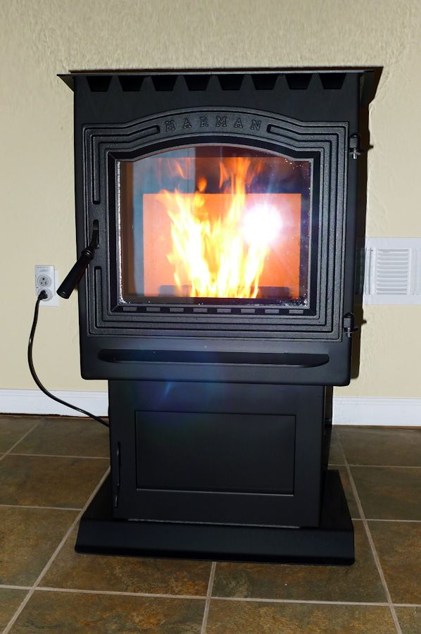

Little tip for installing the door hinge retaining washers. Grab a pair of good sized channel locks, a 1/2" standard depth socket and a post-it note, or some other small piece of paper. Take the socket and hold the retaining ring on the top of it. Now take yer channel locks and put the socket and ring on the bottom jaw and hold it against the bottom of one of the pins. Take the piece of paper and put it between the top jaw and the head of the pin, so you don't scratch the paint. Squeeze. Done. It's MUCH easier done than explained.
When you're ready to fire her up, don't forget the paint is gonna smoke...a lot. IMO, it's best to do it in one long hot burn. It's gotta get done so you might as well get it over with, otherwise you'll be smelling it again the next time you crank her up. Be prepared to listen to smoke alarms going off for an hour or so.
Congrats and enjoy. You're gonna love the heat.

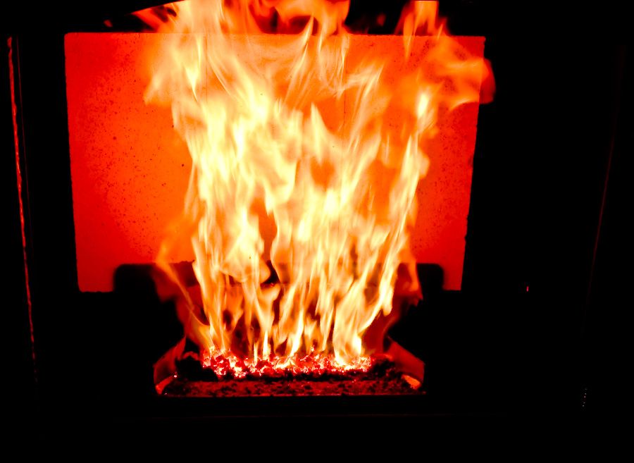

Looks great! That's prob one of the best "burning firebox" shots I've seen.
How long were the smoke alarms going off for? Lol
Congrats! Looks great! Time to update your signature!Thanks! Didn't smoke much at all actually. They didn't even go off but it did smell.

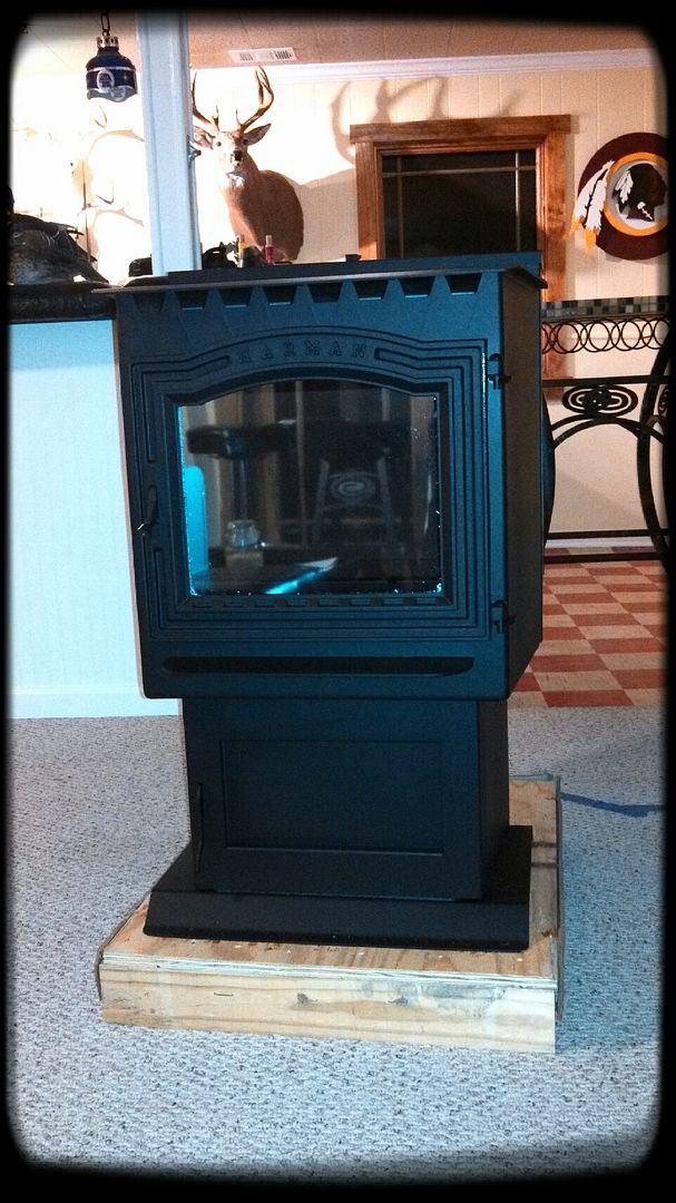

Where did you finally place the stove in the basement A or the breezeway B, and did you install the ThermGuard?

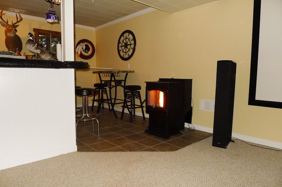

Looks like you have a pretty sweet theater/man cave going on thereGot one....its in the plug. Monster surge with $50k protection warranty.
Looks like you have a pretty sweet theater/man cave going on there![]()
