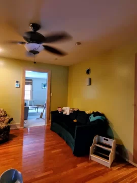

I'm looking to buy a wood stove that will add supplemental heat to our 2,500 sq/ft. farmhouse. The idea is to burn wood by day to heat the downstairs (1,500 sq/ft?) and potentially heat the upstairs at night. The upstairs is only three bedrooms where my wife and two kids sleep.
The location I'm looking at is the old kitchen which use to have a cookstove. It has a clay-lined chimney that is about 16ft tall from the point of entry through the wall to the chimney. The local shop came and deemed it good for use. The cleanout is in the basement, which is probably 12ft the other direction.
The room is centrally located in the house, just off the stairs. The room also has a ceiling fan right by where the stove would be and two return air ducts on each end. We can control our furnace fan from the same room via the thermostat. Most of the connecting rooms have pocket doors that can be closed at night to help move the warm air upstairs where we're sleeping. Overall it seems like a well-suited place for a woodstove.
The only issue is that we don't have much depth before it starts to block the entry into the living room. I know the protective floor covering will go into the doorway area, but I'm trying to keep the stove as far out of the way as possible. (photo attached).

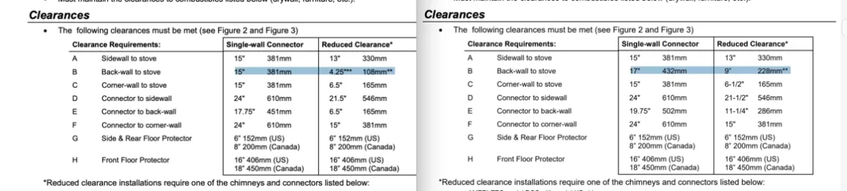

Reading through the new Endeavor (EPA 2020 Compliant) manual it seems like they increased a lot of the clearances. The reduced back wall clearance is now 9", when it used to be <5". Am I reading this correctly?
(broken link removed to https://www.lopistoves.com/TravisDocs/100-01507.pdf)
Also, I see the ceiling clearance is 18". I was told it was 9" for double-wall by the local shop. I believe I have like 13" to work with. They said they can punch a new hole in the chimney, but I would like to avoid that.

The 18” clearance to the ceiling doesn’t say it’s with double wall. With double wall pipe you would go with the listed clearances from the manufacturer of the pipe you choose.
