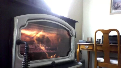

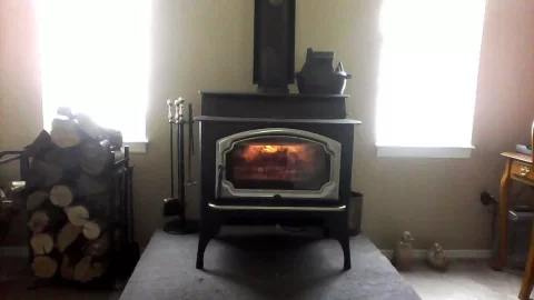

Lopi Liberty over draft
How long was the air shut down before you took the video?

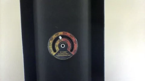

Looks normal to me. Mine burns pretty much the same way with a full load of wood. Maybe I need a damper too! I'm not and expert on double wall pipe but that seems a little high for the surface temp.

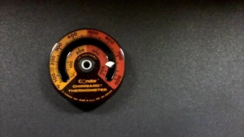

200 degrees is to cool for single wall pipe. 325 to 350 is a good cruising temperature. When mine burns like that my flue temps are anywhere from 350 to 450. If you were over drafting I would think the flue temperature would be a lot higher, but I could be wrong. Next time its burning like that take the thermometer and put it on the stove top in the dead center and see how hot the stove is running.

I do agree it seems my stack temp. seems a bit cool. If I'm having a smaller fire; daytime Stack usually runs around 200 stove top 500-700. When I stuff the stove full at night stack temp is anywhere between 250-375 and my stove top thermometer is maxed out at 750. I don't know why my stack temps are so low.
I'm really interested to see how my burn is with the damper. I'm not crazy about having one as I've heard many bad things about them, but I do think my burn is quite rapid closed down, especailly after seeing this youtube video. It amazes me how slow this liberty burns, Just like my parents Endeavor.
I'd give anything for my liberty to burn like that. After you get the damper installed, could you please post a video of the stove burning with the damper closed when you get a chance. If it truly works and burns like this video I will certainly be installing one

Just something to compare to. Tried to take a video, but video quality was horrible. This is an hour and a half into the burn with the blower on low and air closed completely. 6 splits loaded E/W and one on the side loaded N/S.
