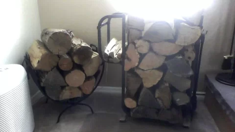

I would say you have an serious issue if you load it that full and its at 100 degrees in the morning, this is driving me crazy trying to figure out what's wrong. What size are your splits?
I'm going to say my splits are about 5 to 6 inches, at least what I burn over night. I try to Burn bigger wood overnight. You think it's driving you crazy, I've been dealing with this For almost a year now, it's driving me insane!

This is the size I try to keep my splits.
