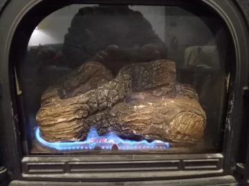

I have an older Jotul 3DVII that I got used from a friend of mine this fall. I had someone install it as far as putting in a liner and the local fuel place installed a propane tank and line. The stove lights but does not seem to heat the space very much even with the doors closed; roughly 13x13 . There are two outer walls but they are both thick brick so not too much loss there. I had the fuel company check the regulator outside today and they said it was fine (didn't give me details). My friend also came and took out the burner tubes and tried to blow out the jet; it didn't seem to change things much. You can feel it giving off some heat but you can leave it on all evening with the doors closed and it gets slightly warmer than the other rooms; plus it has a vent from the oil hot air furnace so it's getting some heat from that as well. Thoughts?
Can you post a pic of what the flames look like?
Hard to get a good angle but here's a shot
[Hearth.com] Low heat or not getting enough heat
Hmm. are you sure the logs are in the correct location? They look to be too close to the front.

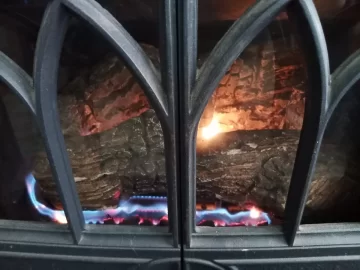

I just had it all apart and put back together, yes that seems to be as far back as it goes. I also opened the air shutter all the way open per the manual (lp) . Here's a picture after doing that, doesn't really look any better. The manual says the back flames should be 3-4 inches high but they basically don't come above the log at all.
Is the regulator adjusted all the way to high?
Does the flame increase when it is?
Have you done a pressure test on the gas valve itself?
There are two ports on the front of the valve, one for
gas pressure coming in & the other for gas pressure coming out.
You need to see what the pressure is going to the burner.
