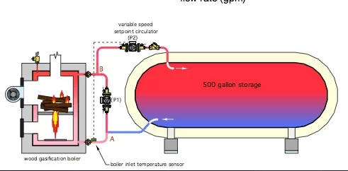

I think this conceptual drawing, from Siggy has some ideal hydraulics. VS pump provides return temperature protection, and properly piped I think it would thermosiphon for power outage, overheat protection.
The pumps present much less pressure drop compared to a 3 way thermostatic valve and should allow passive circulation for no power conditions. There are a ton of inexpensive pump choices and virtually all can be speed controlled with PWM or a simple inexpensive "wave chopper" control, some pumps have the functions built in or a solar controller is a good option.
