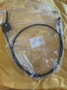

Last year the cable that lets the blower blade down to the surface broke. I could still lift it but could not use the trigger handle to let it back down. I had to jump off and manually pull up the slide up latch and let the blower blade down myself! LOL
Not hard to replace but had to get the correct part number from the manual and order it online for about $28 with shipping
[Hearth.com] LT-1000 Sears Tractor - Snow Blower Attachment Lift Cable Broke!
It Works!
Cable part # 49912 It did come with Trigger not shown on web page. :)
Anyone else have this problem?
