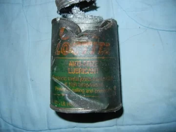

Locktite makes an antiseize with a brush in can. Works very well for a lot of things in a stove with its high heat and almost no flow. Graphite based. Hinges, screws, bolts all good places to use. Smaller tubes can be had too. I don't install a spark plug or glow plug without a dab. A automotive supply will have and if they don't they are not much of a supply house.
