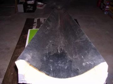

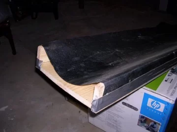

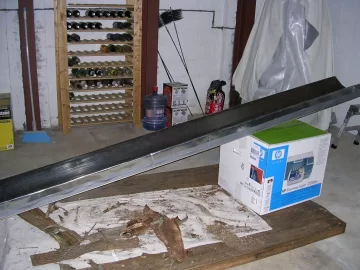

Hello all, I finally got around to making a log chute to get wood into my basement. It runs through one of the windows around 6 feet above the ground. I put the other end on a box so that the logs fall off and don't block the way.
Its 3 pieces of wood, all 12' long. The base is 1x12" and the sides are 1x4", screwed on to the base. Then a 12' length of 20" galvanized steel sheet roll (home depot) was cut to length and centered down the slide. Pushed down in the middle, and nailed onto the side, then duct tape to take off the sharp edges. Works like a charm. Only took me about 2 hours to make.
Dean

Here's another pic from the end:

Interesting. How many splits are you able to deliver prior to the assembly (box and chute) getting filled?? What are the dimensions of said box??
No, I rest the end on a box and the splits fall off onto the floor and roll away. Hopefully my wife will help me out by pushing them out of the way when I do the 6 cords this weekend.
