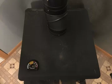

Just got my Madison installed a couple weeks ago, and I did the break in fires and have one thermometer. I was using it on the stovepipe 18" up and like to keep those temps around 300-350. I got curious and out it on the stovetop to check the temps there and to my surprise it likes to climb quickly and was much higher than I thought they would be.
Most of the time it likes to run right around 650 as others have been describing. Last night on a full load after getting it going and pulling the air damper back all the way at around 450 it still climbed quickly and tremendously fast. When it was at around 650 I turned the blower on high trying to cool it off and also had a small fan blowing the warm air out of the room. It got up to 800 and had me worried as the manual does say anything over 650 is An overfire. My chimney is a half foot below the minimum recomended of 15' from the stove top. Single wall pipe up to the chimney ceiling support, double wall class a from there up. Temps outside were around 21* F. My wood is pretty dry, no moisture meter but when you knock on it it gives the hollow ring telling me it's dry, with a few pieces not quite as dry.
Is there any way to stop it from rising so high? There is no chimney damper so the only two options I had I used and it still didn't help. I don't want to damage my new stove but if is going to run at what it likes. I see no warpage today, and at the time it was at 800 nothing was glowing or even close to it. Did anyone find a way to resolve this or talk with englander about why is rated so low yet likes to climb so high?
I am thinking it must have been drafting too much last night but it's hard to believe because the stove chimney is just below their recommendations or right at it.

That's cookin' pretty good. What kind of wood btw? I find the Madison overfires basically anytime you over-feed the burn tubes... wood stacked too high up or wood that offgasses/smolders faster than a bat out of hell.

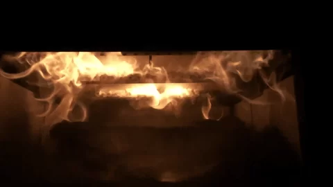

PS- I never get tired of seeing that raging "gates of hell" effect when the Madison's burn tubes are blasting all the way in the back (w/ contribution from the middle)
I did forget to add the type of wood didn't I. Last night I had a lot of barkless dry white oak and maybe a piece of ash. I like to consider my full load below the top of the bricks and in the pic you can see its quite below that level. If I close the damper off too fast it dies, but when it goes, it just goes! I'd be totally fine watchin those tunes rage, only if I knew I wasn't going to damage the stove. I was checking for air leaks etc but found nothing. Thing is with the damper open it usually burns hotter and when closed it usually cruises but last night I closed it down and it just kept on climbing with an intensity that was mesmorizing. When I finally saw the temp start to drop I was a bit relieved. I've seen others say they can't get the stove up to temp, but I just can keep mine down. I need to figure something out so I can start to use some of my locust.
Doesn't sound like you're overfilling it to me then. Do you start fires bottom-up or top-down? I do top-down and find it works very well with the Madison, which means my large stuff is at the bottom and the smaller kindling is up top; since the smaller kindling is up there it will burn down and "recede" from the baffles so the inferno is contained a bit. I also typically stack front-to-back (North/South or N/S as many call it) but that typically serves to intensify the fire more.
jyoung- Maybe you know this already but since you mentioned the fire dies when you cut back the primary air make sure you're cutting the air back in stages. Cut the primary until the fire gets a bit lazy let it build again then cut more air until you get to the desired setting. That can help keep the fire and stove in control.
I didn't see that mentioned what type you have buy it may also be worth checking your thermometer. It would not be the first time one gave an inaccurate reading. Can be right at lower temps and off at higher for instance.
