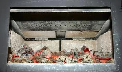

The other thing to check is that the bricks in the baffle are sitting in the correct position above the secondaries. Sometimes they get bumped out of position.
Absolutely. I took a pic of the inside of my firebox for another discussion the other day. I'll reattach it here. Rick

Dow N. Jones said:
...quite the pile of coals! spose u got enuff overhad air?
Closing in on the end of a burn cycle...see the red glow? A little while before, I couldn't have sat in front of the open door to take a pic. When I get a coal bed like that, I open the primary wide and crack the door...more heat from the stove as it burns to ash, reload whenever I feel like it. Some wood coals diferently than other wood. This is Pine & Juniper. But hey, this thread isn't about my stove, Mr. Jones...try to stay on topic. :-P Rick

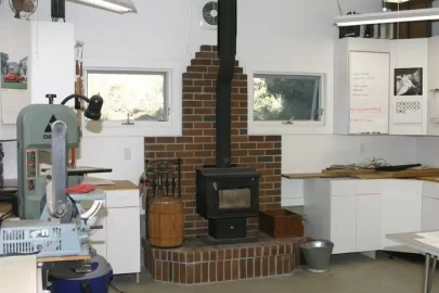

It's the Century Hearth FW240007, the little one. Here's a pic of the stove. Rick

fossi, i like your brickwork; it looks really nice.
