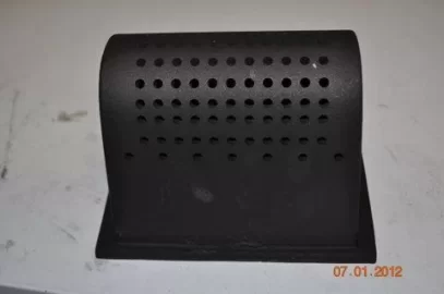

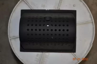

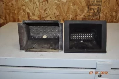

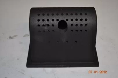

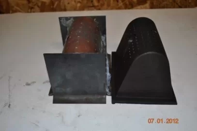

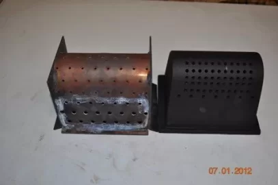

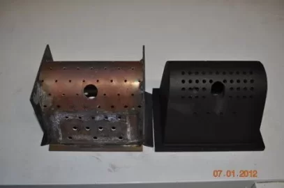

Magnum Baby Cast Iron Pellet Pot

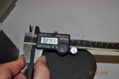

All holes are basically 0.200" diameter....maybe up to 0.015" smaller through some parts of the radius/bottom of pot.

Looking at the pot, I see a tighter concentration of holes at the bottom, less at the back (where the igniter is) and more on the front which would keep the flame from leaning toward the glass. The purpose being to maximize the airflow through the pellets for best burn. I also like the thickness of the lip and I love the fact that there are no open corners like on the stainless pot. I can see where it would work better. I may have to buy one. How much did you pay? They were around $100, right?
Chan
Total with shipping $114. Shipping is flat rate I believe. They also have the stainless pellet only pot for about $87 plus shipping. I didn't see any reason to not go to the cast for $12 more.

Thats a good looking pot for sure. Air in the bottom where its needed.

Don, did you get that straight from magnums website? I didn't see it there. Can you send me the info on it? Cuz I think I just fell in love! .275" thick? Thats a pellet pot there!!! Thanks for the help Don. Think I'm investing in it ASAP!
