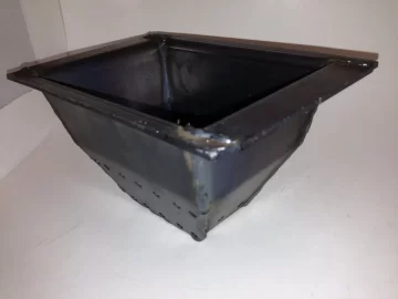

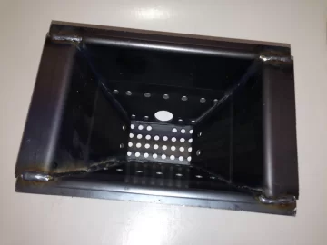

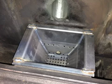

Hey Guys
I have the new upgraded Stainless Steel Wood pellet pots for the Baby CountrySide. Looks like they seal good also!

The stove has the upgraded larger CFM combustion Blower and the upgraded burn pot WITHOUT the top 2 rows of holes!!
The ash pan gasket from the factory is very leaky and the venting was not cleaned in a couple of years.
See pics below
1st Pic - Pellet Burn Pot with no top 2 rows of holes
2nd Pic - New Original Burn Pot with 2 top rows of holes
