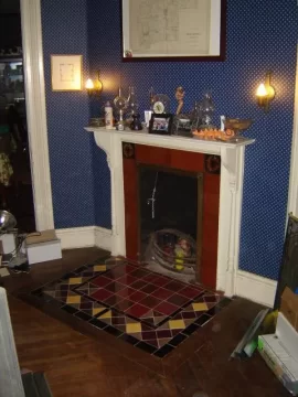

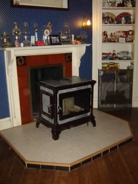

Details: 1885 Victorian w/ many windows, high ceilings, lots of leaks, and marginal insulation. About 2800 sq ft total. 1200 sq ft 1st and 2nd floors, attic is about 400 sq ft finished space. Center chimney is 35' w/ 6" SS uninsulated liner, sheetmetal blockoff plate down below, and I honestly don't recall for sure what's up top sealing the flue. I added a flue damper in the horizontal section straight out the back (we couldn't easily adapt a top-exit setup. Stove will keep the downstairs at 68-74, and upstairs at 60 - even the other day when it was like 12 out. I considered maintaining a 60 degree delta, without using hardly any oil, pretty darn good.
The Mansfield may be too big for 1300 sq ft, but why not give it a try since you already have the stove? Just don't pack it full, try 1/2 or 3/4 loads.
Ed,
By any chance does your house have a Rumford fireplace?

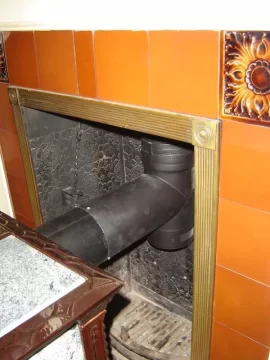

No I don't believe so. It's very narrow and shallow, and tall only in comparison to the width and depth. It's also wide-open at the top (well it was, before we built the sheetmetal blockoff plate around the liner). The hearth is only about 3" tall, and the horizontal rear exit pipe is the only arrangment that clears the top of the firebox. Vertical wouldn't work unless we did massive mods.
Pix show the original hearth/mantel, then the stove on its new hearth, and then a detail of the exit pipe (pre-damper addition - we fixed the male-female connection to aim properly toward the stove).

Hey, Ed...
Is the fluting witht he rosetees around the FP opeing wood?
Sure does look like it...If that's not double wall connector pipe, it oughta be!
You need 18" from single-wall connector to combustobles..If that trim is ceramic or non-combustible, NEVER MIND!
Thx for the concern! The narrow fluting/rosette patten is brass. Then 6" tile w/ the sunburst pattern, and then the white trim is all combustible. And the clearance is all 1/2" over the stated minimums for single-wall pipe as laid out in excruciating detail within the Hearthstone manual.
