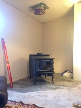

Had the first fire last weekend when it was 80 outside. That's what months of anticipation will do. I still have some trim work left.
Can't thank ya'll enough for the enormous amount of info and advice. Overall the install went smooth. Most of the time was me quadruple-checking every step. I tend to do that, especially when it involves fire.
Now we just need fall to arrive like normal! These 80+ days are ridiculous.

I plan on using reclaimed oak boards for my support box trim since the hole left in the ceiling is larger that trim provided. Think it is ok to leave the insulation around outside of box within the ceiling?
Insulation is fine around the box. The box will maintain proper clearance.

Enjoying the first real fire on the new Lopi Endeavor. So far so good. We are really enjoying it this evening. Didn't take long to warm up burning some soft maple. Insurance man even gave it the OK last week. I believe we will be warm and happy for years to come. Thanks again everyone for all the help on this project. Definitely could not have done it without your help! Cheers!

I've been planning and evaluating this install for over a year, esp for manufactured home ... I tend to overthink, which in a wood stove install I suppose is good. I have a VC intrepid ii (1990 I believe) I installed in my 20x30 barn last winter. It is outstanding. So I had a A LOT of 12-14" splits cut from my dozens of soft maple trees that are begging to be burnt (CSS Jan. 15.) I also have the locust,etc. that was dead and stacked ~1year. Pretty sure it's good, I hope! If not I'll have a soft maple kinda winter. I plan on checking the new chimney on thanksgiving. I am a bit concerned on the low burns building up creosote, as i have noticed a bit of buildup on inside back of stove. My main worries are my 2 little buddies in diapers. Have to make sure they are sleeping in a safe environment. They are the reason I Quadruple check everything.
